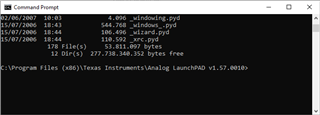

b) Could you double check you have full admin rights for the PC? I am wondering if some security software blocked installation of required dlls in the alp install folder. From ALP install folder, could you check in command prompt what's the number of files and folders you see when you run 'dir' command? See below

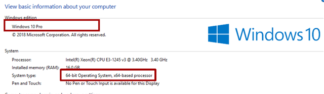

c) Could you share what's your windows10 edition and configuration?
Vishy
Regarding item (b) above, for a clean new install you might see fewer files (184) than my development folder (191). Please share a screen shot of that if possible. Thanks, Vishy
Hi Vishy,
a)yes in that order
b) i have full admin rights and the security software is off.
c) configuration
Rob,
I checked with a clean install: 178 files is correct (I had some development files)
Did you try a clean install? Is ALP starting or you still having issue?
Vishy

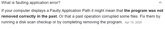

This is what I see regarding faulting application path issue
I was hoping clean install would help your case.
