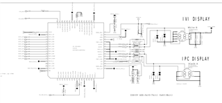

  • Hi sir,
    As so far, we have found  4  of a total of 100 have this issue.
    It is also have this issue when soldered to another normal board.
    Above is our hardware design, and mipi-dsi is 4 channel  output with 540M clk, RGB888 format, display panel  resolution is 1920 * 720 * 60.

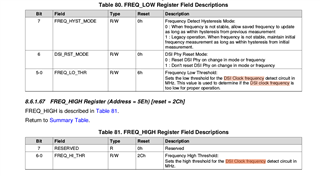

    Lastly, can you also try changing bit 6, field FORCE_CLK_DET of DUAL_CTL2 (0x5C) to 1 on port 1? Does the issue still exist?
    Logan

    3. It is also not work that try changing bit 6, field FORCE_CLK_DET of DUAL_CTL2 (0x5C) to 1 on port 1 .
