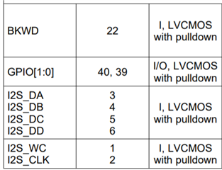

Hi team
Do we need to add external pulldown resistors on these pins? Customer previous design added 10k pull down resistor while they would like to when pairing with 940, must these pins add pulldown resistors or not? Thank you.
Hi team
For the BKWD pin you can pull it to GND with a pull down resistor or connect it to GND directly.
The GPIOs and I2S pins can be left floating.
