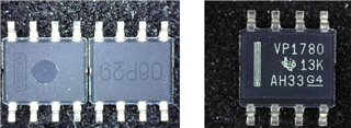

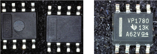

Our customer's QC received these recently from Arrow and observed:
1. Different mold encapsulation between 2 samples from the same reel
2. Different mold encapsulation & print format on the bottom of the chip between 2 samples from the same reel (See 2nd link attached)

Are these possible in a manufacturing environment?
And how would it happen in the case of this part#?
Thank you!

  • Hi Shawn,
    I was able to confirm with our quality team on this. They understood the format of the shared images better than I did, so no need to answer my previous questions.
    Based on the info from the lot trace codes of each device:
    1. Both samples are using same mold encapsulation materials.
    2. The print format on bottom of chip can be different, this is expected.
    Let us know if you have any more questions.
