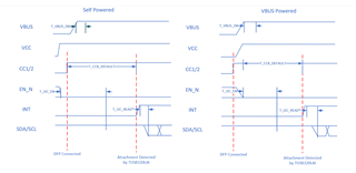

Our customer has asked if we cans share a timing chart from TUSB320 CC detection until 0x08[7:6] CURRENT_MODE_ADVERTISE bit transition.
Could you please share the timing chart with our customer.

Although we suggested to the customer to see INT_N pulling Low then read the I2C, he still requests the timing chart of that.
Could you prepare for the timing chart from CC detection to 0x08[7:6] CURRENT_MODE_ADVERTISE bit transition.

To be honest, I do not know why he needs such an information though, I suppose this use for his software development. Please give him the timing chart from CC detection, CC Debounce, int_N, VBUS, I2C read timing.

sorry. The customer need both powered from VBUS and powered from built-in battery case.
let me recap the customer operating condition,
Port role : UFP
Power supply : VBUS power supply and built-in battery power supply.

Please see image attached below. T_I2C_READ is the delay set by the system/MCU to start I2C read of TUSB320LAI. It is optional and not required by TUSB320LAI. Image is not to scale.
