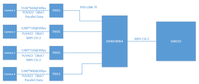

Here I have 2 questions about our 964:
1. Here are 2 solutions I discuss with customer and they previously used 960 and now they would like to use 964:
Solution 1:
Solution 2:
Could 964 directly replace 960 without any changes in software and hardware part in the solutions above?
