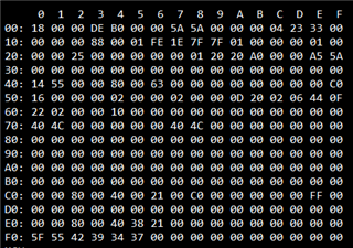

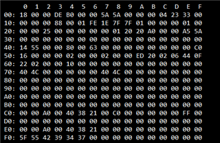

  • Thanks for your reply.here it is.
    947 sch:
    947 register dump:(948 connects 928 and 940)
    947 register dump:(948 only connects 928 )

    If 947 is connected to 928 (HUD) and 940 (instrument) at the same time, the instrument can display normally, HUD can detect the LVDS signal, but the display is abnormal, the LOCK pin level is unstable, read 947 0X5A register as 0XED;
    if 947 only connects 928 , The HUD has no response at all, read the 947 0X5A register as 0X0D.

    This seems like a valid configuration. The fact that you are getting lock and display output on 928 makes it seem like all the display mapping, replication, and settings are correct. However, since 928 lock is instable; this seems to be more of a link margin and signal integrity issue.
    Can you share more about the cabling you are using? Length, etc?
    I recommend you run the Margin Analysis tool from 928 side in ALP. The result of this will give a better idea about the link's margin and help determine that as the issue.
