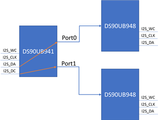

I plan to use a DS90UB941AS-Q1 in 2:2 independent mode to drive two displays with different resolutions.
I also need to transmit two audio channels per display which, on the deserializer side, should be "regenerated" on the same pin for both displays.
Reading chapter "8.3.11.1.3 Audio During Splitter and Replicate Modes" of the DS90UB941AS-Q1 datasheet, it seems to describe this usecase, however only for the splitter and replicate mode.
Question 1:
Is my understanding of "Table 8-7. Splitter Audio Channel Mapping" correct, that when AUDIO_SPLIT is set to one, the mapping is done as shown in the following diagram?
Question 2:
Is splitting audio also supported in 2:2 independent mode?
