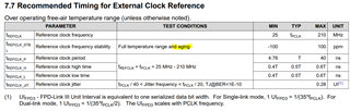

Hi Team,
For the 941AS external clock reference, how long should aging be considered? 1 year? 10 years?

Hi Jared,
It depends on how long the system is specified to last by the customers. If the system is supposed to last 20 years then the reference clock must be within that spec for the full 20 years.
