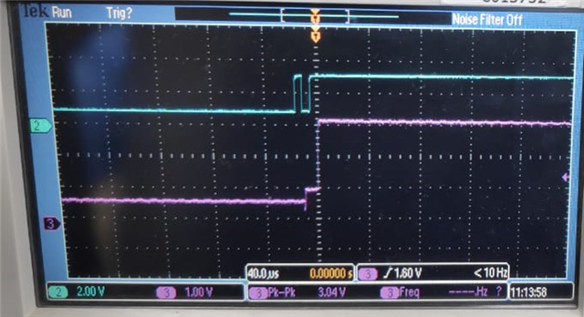

  • I also found that in board start-up every thing works fine.
    but when I give command the START is not being generated means I am not seeing any High to Low transition on SDA line
    when SCL is high.
    and If I go further I am able to see waveforms of data and STOP condition.

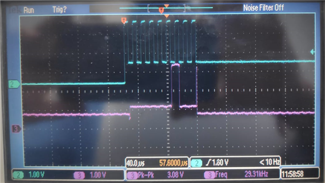

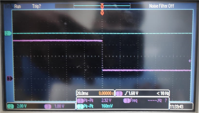

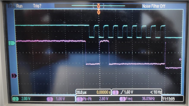

  • Hi
    Here are some snap I have taken while observing START, STOP . register offset and DATA waveforms.
    1. START condition
    2. Slave address (0x20)
    3) Data 1 - 0x08
    4) Data 2 - 0x04
    5) STOP condition
