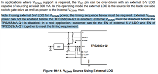

I plan to use TLV766-Q1(Adj Vout) for the external LDO of TPS25830A-Q1.
The datasheet says the External LDO should be enabled after the TPS25830A-Q1 is enabled. The External LDO should be disabled before the TPS25830A-Q1 is disabled.
However the datasheet also mentions that we can tie the EN of external LDO and EN of TPS25830A-Q1 together.
I'm confused little bit about this. Is it saying that powering up/powering down the both external LDO and TPS25830A-Q1 simultaneously is acceptable?
