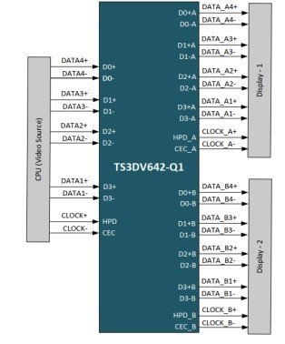

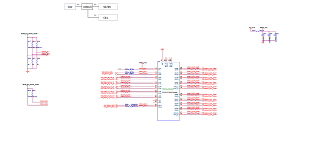

Hi Team,
Could you kindly help to check customer SCH? Whether customer could not link the two I2C(I2CA / I2CB)?

Why do they leave SCL_A/SDA_A and SCL_B/SDA_B floating in the schematic?
David
In this case, I will leave the TS3DV642 pin 3 and 4 floating as well.
David

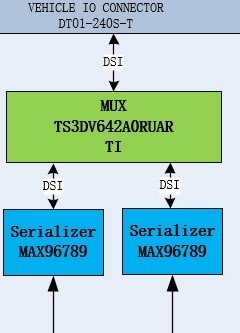

Thanks David. What about other connection?
Because customer want to use this for DSI signal switch. does it work?
If they leave pin 3 and 4 floating, then I don't see an issue with the schematic. The TS3DV642-Q1 can support MIPI DSI.
