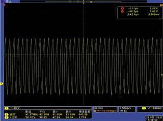

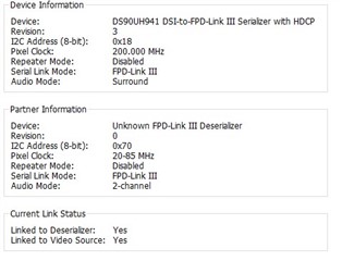

Our setup is 941+984 with external dual DSI and CLK. Our DSI clk is 92MHz*2 = 184MHz. But the ALP shows the 200MHz. I'm not sure if this is the deviation? In addition, can you help check the register setting of 941? Many thanks,
(DSI dual port, DSI CLK0 and DSI CLK1 are 92MHz as below)
