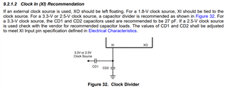

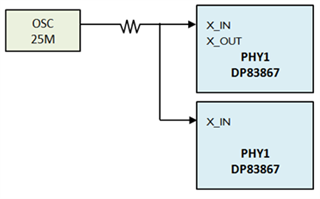

- If MAC is using RGMII, do we need use 125MHz crystal? or we can use 25MHz only? (Because we find RGMII mode corresponding crystal = 125MHz in spec)
- If we pull high the MDIO, do we need connect the MDC to back IC to do the CLK sync?
Can we leave MDC floating or not use the function? Thanks.
