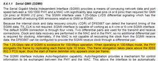

DP83867E: section 8.4.1.1. datasheet clarification
Part Number: DP83867E
Have a question regarding the subject part.  Currently I am planning to use this part in 10/100M mode with an MPSoC.  The MPSoc PS section can only run in 1G mode due to the fixed clock in the block. Will this part be able to work 10/100M  hooked to that?  I see in section 8.4.1.1 of the spec that it does a bit compensation for 1G interfacing, but not real sure what it is telling me.   Quick clip below.  Thanks
