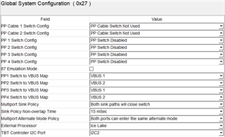

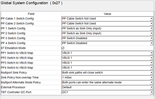

I program the TPS65988 with configurations like the below:
But when I enter debug mode in the Application Customization Tool I see that this register has this configuration:
When I change in debug mode, for example, External Processor to Default (like it is in my configuration) the TPS65988 starts to work and negotiates the voltage like it is configured in my Sink PDO 2. Without changing anything it doesn't work (no negotiation), all switches are disabled.
How to properly configure this chip to make it work after connecting the USB PD source?
