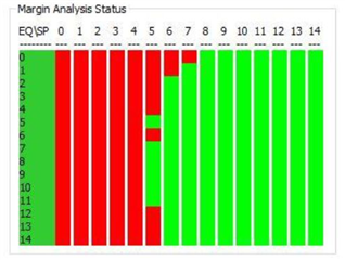

    Paired to a 954EVM board we got following margin analysis plots at room temperature  resp. started at -33°C:
    Torsten
  • Hi Torsten,
    Room temperature looks really good, but the cold start looks passing as well.  Should be able to set AEQ limits with the data that was provided and get have a working link correct?
    Also I understand you want to make STP and coax applications, I was just saying we tend to see slightly better performance with STP however should work in both applications.

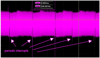

    I analysed the DOUT signal of single ended signal at coax cable. Beginning by 0x52:= 0x67 there are some disruptions. If the camera is cooled down completely (< -33°C) there are some stable signal diagrams:
    What could be the reason why?

  • Hi Torsten,
    I am not sure that using 2Gbps will result in any increase in transmission distance since our channel spec is only defined for cables up to 15m and isn't dependent on the speed of the forward channel.  With that said is there anyway to measure the quality of the channel at room temp vs cold temp.  Is it possible to compare s-paramters of the channel at cold vs room temp?  If the only way to recreate the communication issues is too cool everything down to <-33  degrees then I would argue this is a system level issue and the channel characteristics are affected by temperature.
