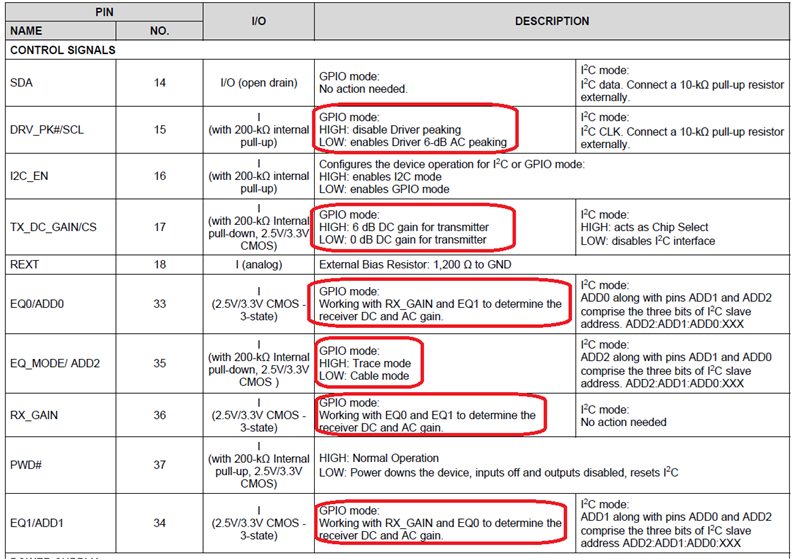

    Can you send me your schematic? Also, what is the current setting for DRV_PK#/SCL, EQ_MODE, EQ0/1, RX_GAIN, TX_DC_GAIN?

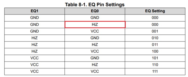

    BTW, as EQ setting table, how to set the input is HiZ?
    Thanks.

    HiZ means leaving the pin floating.

    May I have your suggestion about the settings of EQ_MODE & TX_DC_GAIN & DRV_PK# & RX_GAIN for both of them?
    2. What's the definition of DRV_PK? And what signal will be adjusted by this pin?

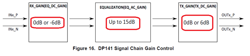

    3. Does TX_DC_GAIN is the output signal of pre-emphasis? What situation will choose 0dB and what for 6dB?
    4. For RX_GAIN, what situation will use 0dB and what will use -6dB?
    Thanks.
    When TX_DC_Gain = 0, it sets the output linearity range to 600mVpp. When TX_DC_Gain = 1, it sets the output linearity range to 1200mVpp.
    RX DC Gain and EQ0/EQ1 work together to determine the best setting, please refer to Table 3 of the DP141 datasheet for the different scenario. For this particular case, you probably want to use the last 4 setting in the table.
    DRV_PK adds an extra 6dB of high frequency gain. Boost happens between 6 and 10Gbps.
    Do you have a high speed scope that can physically measure the DP141 output signal quality?

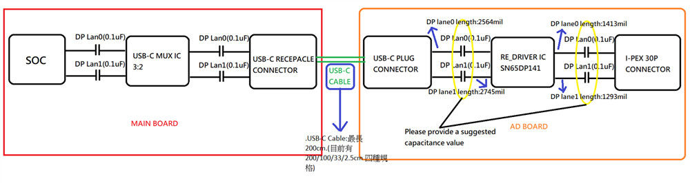

    For display board(AD board) and USB cable, please refer to the below chart.
    This chart is for connection with USB cable.
    For without cable connection, customer can connect 2 board with USB connector.
    --> USB-C Cable:Max. 200cm.(there are 4 type cable: 200/100/33/2.5 cm)
    --> AD Board DP Lane 0 Re-driver: 2564mil; D1 Lane 0 Re-driver: 2745mil
    --> AD Board DP Lane 0 Re-driver: 1413mil; D1 Lane 0 Re-driver: 1293mil
    I summary the question below, please help to give comments.
    1. customer design will have 2 configurations, display board <-->  USB-C cable <--> main board, and display board <--> main board.
    2. . Does TX_DC_GAIN is the output signal of pre-emphasis? What situation will choose 0dB and what for 6dB?
    3. For RX_GAIN, what situation will use 0dB and what will use -6dB?
    4. Please also suggest the cap value of yellow marked.
    Thanks.

    The DP141 is a linear redriver, so we will only configure the DP141 to compensate for the loss between the Type-C plug connector and the DP141 in both cases. The SOC and the DP sink will compensate for the remaining loss through the DP Link Training. Assume 5.4G data rate, the loss for the 2.564in trace is around 1.5dB. I would try with EQ_MODE of 1, EQ_SETTING of 000 and 001, and DRV_PK# of 0.
    No, TX_DC_GAIN set the output linearity range. I would set TX_DC_GAIN to 1 to give you the maximum linearity range.
    RX_DC_Gain and EQ0/EQ1 work together to determine the best setting. For now, I would set RX_DC_GAIN to 0.

    Between the USB-C Plug and the DP141, TX1/2 -> 0.1uF or 0.22uF. RX1/2 -> optional 0.33uF or 0.47uF. But since this is a Type-C application, the DP141 will not able to support the Type-C normal and flip orientation, so who is supporting the Type-C orientation?
    Between the DP141 and the I-PEX connector, 0.1uF is ok.
