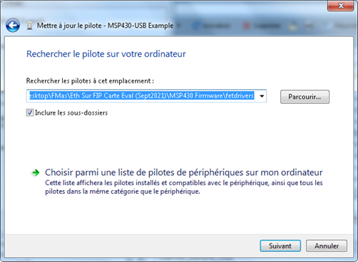

Here is my configuration : The DP83TD510E-EV  board is connected with USB plug. I strap R24 as recommended and the jumper USB 5v is on.

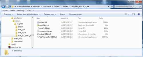

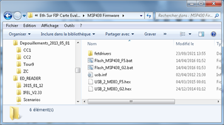

The board power led's are on. USB is plugged on the PC and the device management panel on Win7 see the MPS430 usb example board with (!).
as I up date the driver and point out through the driver I did download the package fetdrivers from the link from the guide and from here : MSP430_FET_Drivers 1_0_1_1 - TI.com
After installing the package Win7 refused to install the driver as I try to update the MSP430 driver, Win7 says : "No driver has been found on your computer."....
Could you confirmed me about the driver link I use to download the setup driver ?
is this issue known already ?
Thx
Fab

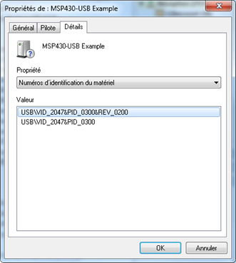

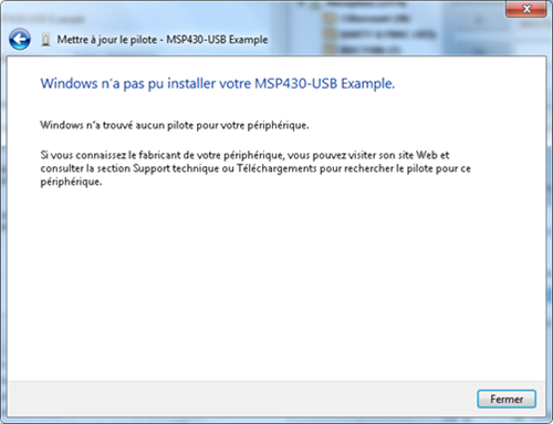

  • Hello Sreenivasa
    I only have Win7 PC x64 for this board 511e connection.
    About the installed driver:

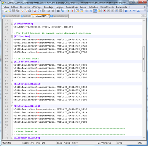

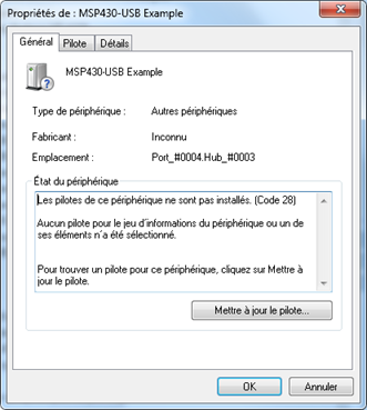

    I download the driver (snlu271A.pdf - guide link :  software-dl.ti.com/.../index_FDS.html.) I have driver in : msp430/USB_FET_Win7_8_10_64/ in that folder I have file:  usbuart3410.inf . In this file in section [TI.Section.NTia64] the device name is USB\VID_0451&PID_xxxx
    After plugging the board on the USB PC the name in the "peripheries management"   is " MSP430-USB Example". When I open the properties on this MPS430 the hardware ID device is :
    USB\VID_2047&PID_0300.
    When Win7 tries to install the driver it found no driver available that match the hardware, isn't it normal ?
    the goal is to establish the communication (same way I did with 2 boards 811E ), I probably need to turn 1 board 511E in master and 1 board 511E in slave mode linked with 1 twisted pair. Do I need to do this configuration (M/S) with the SW USB-2-MDIO Tool ? An so the need to correctly install the USB 511 driver ?
    Thx
    Best regards
    Fabrice

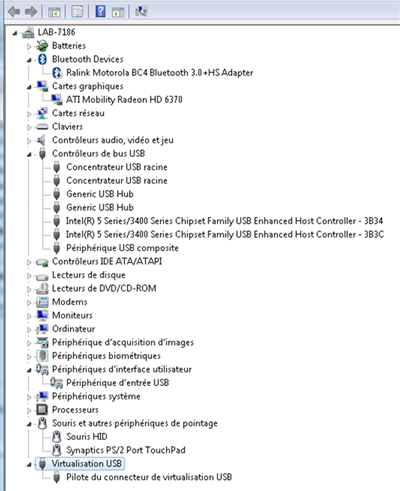

    I think I do not have the correct driver to access to the board with the USB-2-MDIO SW :  The MSP430 - USB device still unrecognized because of the wrong driver.
    here is what I did install last week :  why the pic quality is so poor ?
    best regards
    fabrice

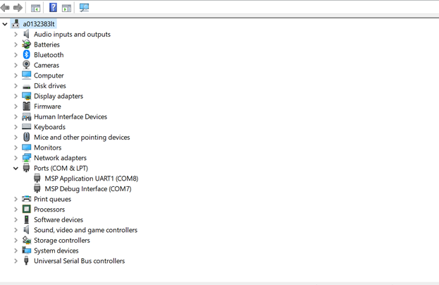

  • Hello Jo,
    Please check available  ports as below
    I set the port as com8.
    DP83TD510E has been set to PHY address 00
    Extended registers - set it to No.
    Please try reading the registers.
    Sreenivasa
  • I do not have "MSP appli UART or debug" on Port COM , in fact no port com is loaded on my PC. When I remove the HW 511 board, the MSP430 (!) disappear from the management devices panel :
    The issue is : wrong driver for this 511 board. Please send me the correct driver for win7 x64.

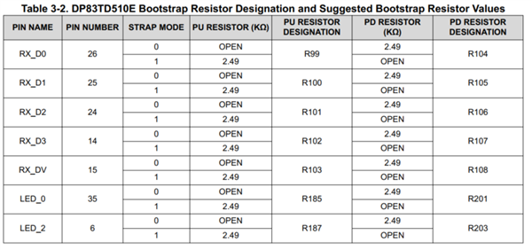

    Hardware Strapping • Populate R84, R103 with 2.49k (1%) • Place shunt on LED_0, J20 in "Mode 0" position
    Sreenivasa

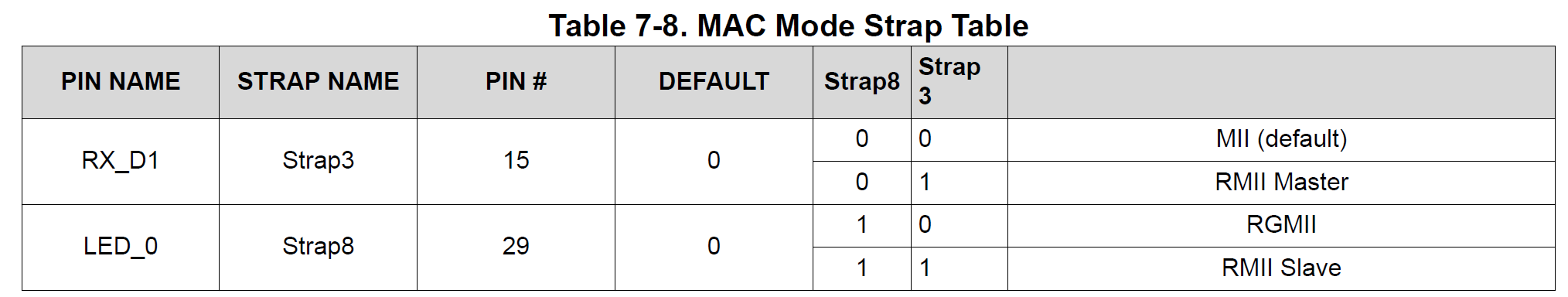

  • Do have I the correct table ? Pin #15 is RX_DV not RX_D1 ?
    Do I really need to do all these modifications to turn 510E (slave) & 8221 (Master) ? :
    3.2.2 DP83TD510E in Slave Mode, DP83822I in Master Mode
      • Populate R136, 138, R143, R25
      • Remove R135, R137, R149, R91
      • Set the correct hardware straps or perform the correct software write.
    Hardware Strapping
      • Populate R84, R103 with 5.76k (1%), R108 with 2.49k (1%)
      • Place shunt on J20 in "Mode 1" position
    Software Programming
      • DP83822I
        – Write register 0x0017[5]=1
        – Write register 0x0017[7]=0
      • DP83TD510E
        – Write register 0x0017[7]=1
    This sentence : "Set the correct hardware straps or perform the correct software write."
    tells me I can do HW modifications OR SW modifications to turn board Master OR Slave.
    Is that correct ?

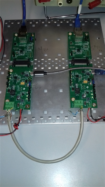

  • To proceed with the HW modification have you got a board plan with components localization (native pdf)  so I can research easier to find resistors place ?
  • snlc068.zip
    Hello Fab,
    Please see attached.
    Sreenivasa
  • Hi Sreenivasa
    Thx, this is what I was looking for, great !
    I will try the driver MSP430 with another PC (Win10) if I found the correct machine, and then I modify the HW after.
    I'll get back to you later on the week after these tests.
    Fabrice

    Question  : what about this clock signal when the board is turn (HW or SW manner) on slave mode for 510E and master for DP83822 (table below) ?
    In final do we need to care about R91 ? It seams to me that R91 (DNP) have no impact on M/S mode. Am I right ? If yes I can remove it from the table and from (SNLU271A) guide.
    Where did you fined this image table ? I can't find it inside the guide ?

  • Sreenivasa
    I wonder if you can give me explanation about the MSP430 driver problem.
    Do I install the wrong on ?
    Is the ID name correct ?
    And on the .inf file, is it correct ?
    I've place many screen shots below, if you can tell me where am I wrong ? Thanks
    Inside the driver package :
    The usbuart3410.inf file : USB\VID_0451   but the driver HW ID says : USB\VID_2047
    Don't you think there is an issue ?
    Do I select the correct path ?
    But Win7 said : can't find any driver ....  Do I select the correct folder ?
    Do you really think it 's a Win7 Version issue ?
    Best regard
    Fabrice

    I've tried on a Win10 PC and it does work fine this time, communication with the board is ok now. This time I need to modify the register to modify Master/Slave mode and I have misunderstanding the guide:

  • Hello Sreenivasa
    I' ve done configuration as defined below :
    Config 1 (Eva board couple 510E N°1) Master on 510E & slave the other :
    510E in master mode => PHY ID (0) write reg 0017 with x4031 (0100 0000 0011 0001) bit 5 = 1 & bit 7 = 0
    838221 in slave mode => PHY ID (5) write reg 0017 with x00F1 (1111 0001)  bit 7 = 1
      and :
    Config 2 (board couple 510E N°2) Slave on 510E & master the other :
    510E in slave mode => PHY ID (0) write reg 0017 with x4071 (0100 0000 0111 0001) bits 5 & 7 = 1
    838221 in master mode => PHY ID (5) write reg 0017 with x00B1 (1011 0001) bit 7 = 0
    Bit 5 always 1 on 510E or 838221
    I notice the configuration isn't permanent ? Each time you reboot the boards you have to rewrite the registers ?
    Is it normal ? Is it user friendly ?
     Strap config :
    R24 : strap : 0 ohm : Power through USB only (no power on J12)
    J9 (USB -5V) : Jumper ON (both board )
    J19 (LED_0) : board 838221  : What is the correct position for this jumper for each board ?
    J20 (LED0) : jumper 1-2 position on both board => correct ? The guide say J20 in '0' position and you tell me above '1-2' position ? What should I do ?
    R149 signal : 50Mhz on one board   &  5MHz on the other  => Normal ?
    U will find below 2 pics of the 2 boards, you can clearly check the jumper positions , could you please tell me if these positions are correct ?
    I've plugged the Eth analyzer on each board but communication between boards isn't possible, regarding the config.  I suppose, it still remains an issue.
    LED_0 is flashing both 510E boards
    For jumpers config. :
    Board 510E in slave mode :
    Board 510E in master mode :
    Thx for your information's.
    best regards
    Fabrice
