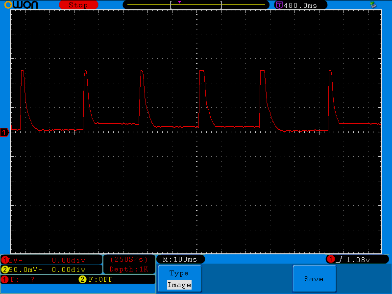

I am currently using TPS65994AD for my Surface Tablet. My platform includes Embedded Controller, Retimer, CPU that can communicate with TPS65994AD. I use Application Customization Tool to generate a configuration file for TPS65994AD and flash it to EEPROM.  My platform only uses a Type-C Port A and I also use EC to read status register of Port A. Everything work well, but there are some problems:
1. When I use a Power Supplier that supports USB C PD plugged into TPS65994, it only autonegotiates sink successfully with a Plug Orientation and other Plug Orientation don't  work.

2. When plugging in a USB C hub https://www.ugreen.com/products/5-in-1-usb-c-hub-with-4k-hdmi , TPS65994AD doesn't supply 5V to VBUS.
  • Register Value:
    • 0x1A STATUS: 0x0040000020, sometimes is 0x0000000000 or 0x0000000020
    • 0x26 POWER_PATH_STATUS: 0x4000000000
    • 0x3F POWER_STATUS: 0x0000
    • 0x40 PD_STATUS: 0x01000030
    • 0x41 PD3_STATUS: 0x00000000
    • 0x69 TYPEC_STATE: 0x64020200, sometimes is 0x66000000 or 0x64010200
  • Note: At now, my platform hasn't booted up CPU, only TPS65994, EC, Retimer work
  • This is wave form of VBUS signal:
  • Application Customization Tool project:
TPS65994AD.pjt
Please help me find out problem.

  • Vu Dinh,
    There seems to be a Hard reset occurring, and also the EC is not clearing the interrupt events (Refer register 0x1A and 0x40.
    Can you please share the PD logs and internal PD State Trace? For State Trace, open GUI, Debug->Debug Mode->Port X->Commands->PD State Machine Trace and click on Download when the issue occurs. Copy the text you see in a text file and attach it here for investigation.
