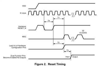

Hi all
Would you mind if we ask DP83867IR?
During "Latch-In of Hardware Configuration Pins", could let us the condition of output pins - RX_D0-D1?
Are these pin Hiz during boot strap setting? These pins are not low-level, right?
Kind regards,
Hirotaka Matsumoto
  • Hello Matsumoto-san,
    These pins are not Hi-Z. They are default pulled down during sampling by internal resistor (See Figure 25 of datasheet) unless otherwise connected to outside resistor network.

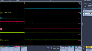

  • Gerome san
    Thank you for your support always!
    On the the customer board, after Reset_N=high, RXD_D0(strap_setting) and RXD_D1(strap_setting) will be low level.
    The customer resitance setting : Rhi=2.49k, Rlo=open
    Before reset setting : 9k*(2.49k+9k)×1.8V=1.4V -> we think this is OK.
    After reset setting : we don't understand why the voltage will be GND level.
    If you have some advice, could you let us know?
    Will RXD_D0(strap_setting) and RXD_D1(strap_setting)  be open drain output with some setting?
    Kind regards,
    Hirotaka Matsumoto
  • Hi Matsumoto-san,
    These pins are outputs, so once they are out of the sampling stage, these nodes will be driven by the PHY. This behavior is normal and is indicative that the PHY is not sending any data to the MAC at the moment.
    Sincerely,
    Gerome

  • Matsumoto-san,
    Thank you for your response.
    Yes, during the strapping, the voltage is dependent on the voltage division set by the resistor network shown in table 5 of datasheet.
    After strapping, the voltage will be low as this output pin is indicating that no traffic is being sent to the MAC. Since this uses SGMII_COP/CON and the customer is using 4-wire SGMII, it would make sense that this pin is GND as it is unused during this mode.
