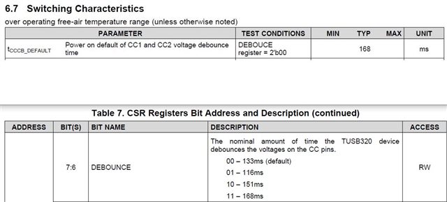

Our customer has questions about DEBOUNCE register bit and the specification mismatch as well as I2C reset condition.
Although tCCCB_DEFAULT specify 168ms at DEBOUNCE register=2'b00, it also specify 133ms (default) in the I2C register bit Table 7, as shown in below. Could you help him which number is correct default DEBOUNCE time.
Could you also help him if I2C registers are default once VDD is shut down.
