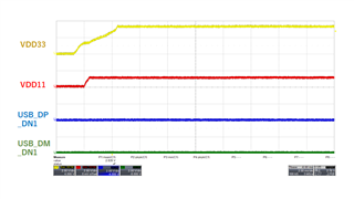

In the following post, I told you that the voltage of USB_DP_DN1 rises due to the influence of BATEN.
https://e2e.ti.com/support/interface-group/interface/f/interface-forum/1043553/tusb4020bi-usb_dp_dn1-output-voltage/3859695
If you remove pull-up resistor for the BATEN , USB_DP_DN1 will not rise.(see the figure below)
What is the correct way to connect the BATEN pin? (Pull-up or pull-down, NC).
