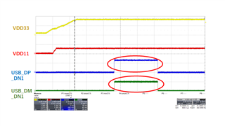

Hi Nishie,
Yes, Brian has shared the schematic. For your application, there should not be a pullup on PWRCTL_BATEN for the port that has a permanently connected device. When the hub has battery charging enabled and the USB_VBUS is low, DP and DM are shorted by the hub downstream port (DCP mode). When the permanently attached device powers on it will have a DP pullup, which will be reflected on the DM line in DCP mode. This is causing the pulse that is seen.

The waveform measurement was performed by opening the USB_DP / DM_DN1 line of the circuit diagram.
A pulse similar to the previously sent waveform is output on this line.
Is it correct to output a pulse even if the Downstream port is opened?
In addition, the pulse output timing and pulse width are random for each device.
Do you know the cause of the random output?

Hi Nishie,
I was able to confirm this behavior is related to the battery charging feature enabling on in the downstream ports of the TUSB4020B. The pulse on DP/DM is related to the time between TUSB4020B powering on/exiting reset and when it detects USB_VBUS on. Even if VBUS is on at power on, it will not be detected immediately by the hub.
My recommendation is to disable battery charging by removing the pullup on PWRCTLx to prevent the pulse in your system on the internal ports.

Hi Nishie,
For the TUSB4020B, when battery charging is enabled on a downstream port and it is in DCP mode (no upstream connection, USB_VBUS off) there will be the voltages on DP/DM lines. In the customer system, when the TUSB4020B powers on, battery charging is enabled and by default USB_VBUS is considered off until it has been sampled and debounced. This time for sampling and debounce of USB_VBUS is the time of the DP/DM pulse on the downstream port. For this short time, the downstream port is in DCP mode. The timing will vary depending on the customer system. To remove the pulse, they should disable battery charging on the port entirely.
