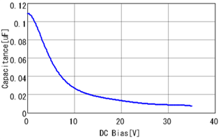

  • Hi Eric,
    Thank you for sharing the great blog, however I was having a difficulty finding the answer to my original questions.
    My questions is if I need to consider effect from DC bias, temp, etc. when choosing capacitors, or not.
    For example, below is DC bias characteristic of 0.1 uF cap. If DC bias is 10V, the capacitance would be reduced to 0.02~0.03uF.
    I should choose cap for C1 that can guarantee at least 0.1uF under worst case scenario (including DC bias, temp, etc.), is my understanding correct?
    For the second questions, it was mentioned on the blog that large cap doesn’t always mean the better ripple performance. So I’m guessing too large cap is not ideal. But if that was wrong, please let me know.
    Kurumi
  • The capacitor values are nominal, but this device was originally designed for electrolytic capacitors without DC bias effects. So the acceptable tolerance is ±20%.
    If you are using MLCC capacitors, then you have to ensure that the DC bias effect is no worse than that. So you must use larger packages.
    Larger input/output capacitors make the ripple smaller (because the charge moved by the flying capacitor is smaller relative to the charge on the I/O capacitors). Larger flying capacitors make the ripple larger (and the ripple frequency lower).
    Larger electrolytic capacitors have higher ESR, which can make the ripple worse, but this is not a problem for ceramic capacitors.
