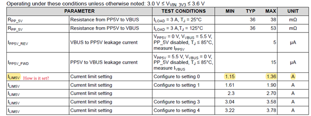

        A. Page 11, ILIM5V

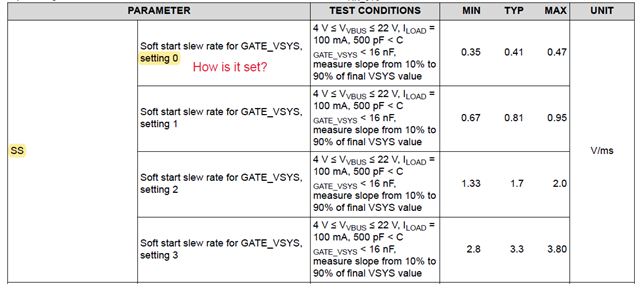

      B.Page 13, SS

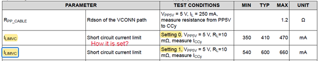

    C. Page 17, ILIMVC

      1. You should connect the USB lines to the TPS25750.  It will take the B1.2 negotiation into account when setting the current limits
    2. How and where following parameters of TPS25750 can be set?
      1. We are working to document to describe the events and register updates that the TPS25750 executes and then you can supplement with your MCU.

    4.  The section of the spec that you are referring to is the type C values.  They are 900mA, 1.5A, and 3A.  If you add in PD functionality, then you are able to program current between 0 and 3A for voltages other than 20V and up to 5A for 20V.

    Ad4. Sorry, havent you only repeated what I had written in my question? I have asked how Type-C current advertisement (default, 1.5A, and 3A.)  can be configured. I suppose when ILIM5V can be set (see 8 A) then current advertisement has to be configurable as well.
    General Note: Maybe TPS25750 Application Customization Tool doesn’t provide full configuration which can be achieved via register setting by AP over I2Cs interface. Then it is necessary to explain or describe as I am as a user often confused what is possible and how.
  • 2. From a PD standpoint, the enablesource_port1 event will transition high when the data port is configured as a UFP and low when it is configured as a DFP.  This will match the OTG EN as closely as type C allows.
    4.  The TPS25750 is currently only available as a 3A advertisement for type C only connections.
