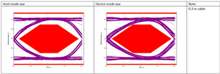

TPS25830A-Q1: When TPS25830A-Q1 was operating in device mode, the DP/DM out eye diagram performance will be worse than operating in host mode.
Part Number: TPS25830A-Q1
Hi team,
We find that the eye diagram performance is worse when we set TPS25830A-Q1 in device mode. But as I know, both of host mode and device mode should pass through the internal MOSFETs. The only difference is buck converter whether is under operating.
Can you let me know the result is normal or not? Thanks.
