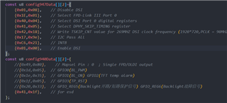

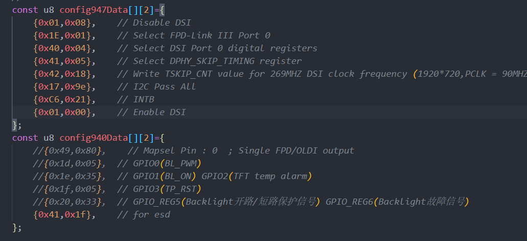

Software info- Here is the register configuration of 947 and 940N:
In my opinion it should be configured from 947 side rather than 940N side right? What other registers should be configured in 947 or 940N?

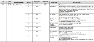

I also have questions about this 0x12 register, in our system block diagram, how could we configure this register and what does the 'I2S channel B' mean?

    This code doesn't contain any of the I2S specific register writes. Are they not modifying any of those registers directly?

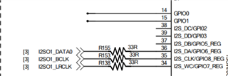

    2. About the I2S question, how to config 947 and 940N to successfully test the 940N I2S output since I have told customer to configure 0x12 register in 947 and what registers should we configure in 940N? They just use one channel I2S output (I2S_DA rather than I2S_DB/DC) and I have shown the schematic in this thread previously, could you please help to take a look?
     I have also found that they wrongly configure the 940N GPIO6_REG and tell them to let it be default to be the I2S output, do you think it is right? Please help to provide us some suggestions whether there will be another registers to configure in 947 and 940N to gain the I2S output, thank you.
    What I2S clock rate will be used, this is one additional thing that might need configured.
    This should not take much configuration. Keep 0x12[1] set to Data Island Transport, keep 0x55 as default if TDM to parallel isn't being used. Ensuring the I2S outputs are configured as outputs in 940N.
    On 940N side, you can read in 0x28 to verify the settings are getting programmed correctly from 947.
