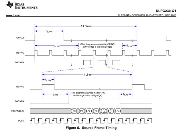

  I use DS941 with single mode,  input: DSI0, output:port0, as follow,
Use DLPC230 resolution size:1152x576

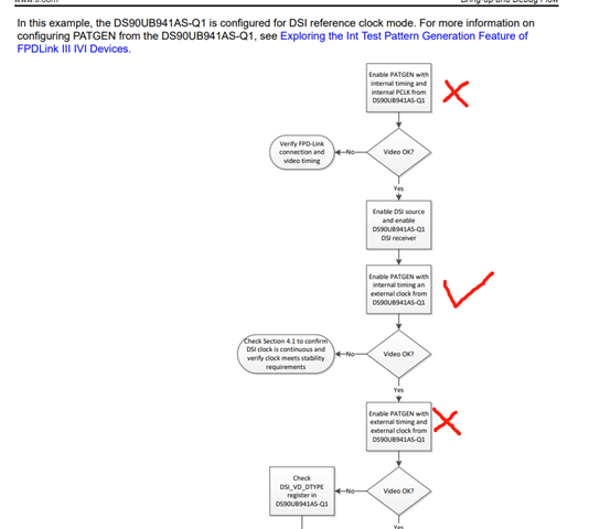

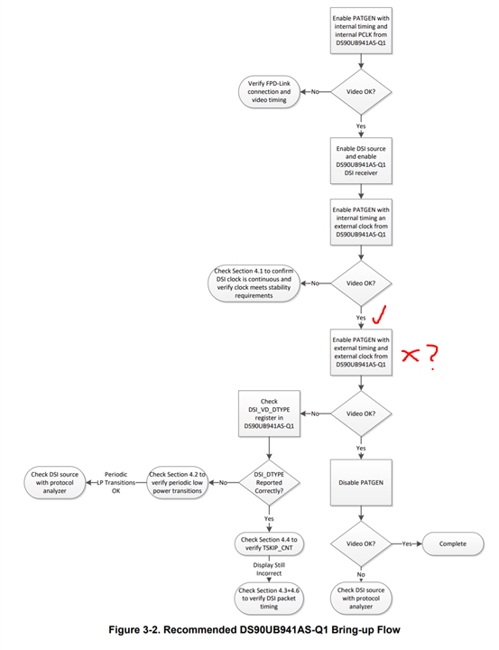

  • Zhang,
    Where exactly are you stuck in the debug flow chart from the app note that I linked before? Are you stuck here? Have you tried enabling PATGEN with external timing and external clock and it failed? If so, then did you check the reported DSI_VC_DTYPE in the 941AS registers? What does it report? The easiest way to debug your problem is to follow the step by step flow chart
    Casey
  • Dear Casey,
      My lcd is dlpc230, which resolution is 1152x576@60fps,44.426Mhz. The ds941 doesn't support the clock with internal clock in test pattern mode. Is it true?
    I have to enable patgen with external clock.
        set register 0x65 to 0x0C, pattern display ok.
        set register 0x65 to 0x09, pattern display fail.

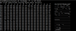

    My test result:
    thanks!

    My dsi input timing configuration is:
    static const struct display_timing ti_ds90ub941_timing = {
        .pixelclock = { 44426000, 44426000, 44426000 },
        .hactive = { 1152, 1152, 1152 },
        .hfront_porch = {  40, 40, 40 },
        .hback_porch = { 32, 32, 32 },
        .hsync_len = { 8, 8, 8 },
        .vactive = { 576, 576, 576 },
        .vfront_porch = { 3, 3, 3 },
        .vback_porch = { 14, 14, 14 },
        .vsync_len = { 8, 8, 8 },
        .flags = DISPLAY_FLAGS_HSYNC_LOW |
             DISPLAY_FLAGS_VSYNC_LOW |
             DISPLAY_FLAGS_DE_LOW |
             DISPLAY_FLAGS_PIXDATA_NEGEDGE,
    Refer dlpc230-q1.pdf.
    thanks.

    For example, with M = 3 and N = 54, you should be able to get quite close to 44.4MHz with internal clock. But if the PATGEN works with external clock already then it's ok. So if the PATGEN with external timing doesn't work, then you need to move to the next step in the flow chart which is to check the DSI_VC_DTYPE reported through the 941AS DSI indirect registers. Did you move to that step? What was the result?

    3. dlpc230 frame timing:

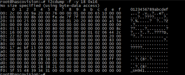

    4.registers setting:
    DSI status:
    root@hascovision:~# i2cset -f -y 18 0x16 0x40 0x05
    root@hascovision:~# i2cset -f -y 18 0x16 0x41 0x20
    root@hascovision:~# i2cget -f -y 18 0x16 0x42
    0x6f

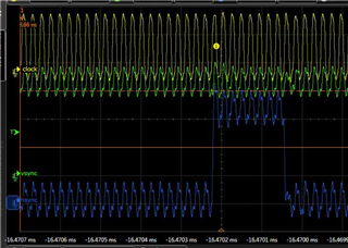

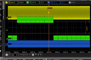

      After set indirect  register 0x20 to 0x7F, 0x05 to ox08, I get waveform. Maybe the vsync_len is not correct. At DSI side,  .hsync_len = { 8, 8, 8 }, vsync_len = { 8, 8, 8 }. But the ds941 out side, the vsync_len value is 6. The waveform as follow. Does the ds941 modify the vsync_len? How can fix it? thanks!
    patgen mode is correct. waveform as follow:
  • Hello Zheng,
    In DSI pulse mode, the 941AS uses the received DSI packet timing from the source to generate the timing of all horizontal and vertical timing parameters. It does not modify the VSYNC/HSYNC length from what is received. See section 2.3 of the DSI bringup app note, specifically section 2.4.1 for details on the DSI packet structure. The length of the Vsync pulse is defined by the number of lines between the VSS packet and the VSE packet from the source.
    So this issue seems like it is resulting from an error in the DSI output vs. what you are expecting it to output. Section 4.3 of the DSI bringup app note gives detailed instructions on how to verify the DSI packet timing from the source to diagnose where the problem is coming from and figure 4-3 shows how to measure the Vsync length in a DSI packet decode.
