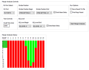

Dear Shruti,
I need some clarification on the use of Automatic Equalizer (AEQ). In particular, I have a Deserializer evaluation board connected to a serializer  evaluation board. After start up I set some registers by means of the I2C interface. You find in the following the initialization procedure I use. iI is written in C code and function write_register takes as inputs (device_address, register_address, register_data). In red you will find some questions:
write_register (DESER_954, 0x01, 0x02)); //force a reset of the deserializer
write_register (DESER_954, 0x0C, 0x81)); //enable port 0
write_register (DESER_954, 0x4C, 0x01)); //access to port 0
//indirect access to register 0x08 (STROBE_SET) of port 0 to set base delay = 0
write_register (DESER_954, 0xB0, 0x06)); //access to specific registers of PORT0 with auto increment enabled
write_register (DESER_954, 0xB1, 0x08)); //indirect register address = 0x08
write_register (DESER_954, 0xB2, 0x00)); //write 0x00 into indirect register
write_register (DESER_954, 0x42, 0x71)); //Loop position + Errors checked (default values)
write_register (DESER_954, 0xD2, 0x94)); //AEQ settings left as default
write_register (DESER_954, 0xD5, 0xE0)); //Max/Min EQ Levels
write_register (DESER_954, 0x41, 0xE4)); //Max/Min STROBE positions (SFILTER level)    -->    here my intention was to put 0xE0 to give the AEQ maximum freedom to select the best strobe position between 0 and 14. Nevertheless, if I put a value between 0 and 3 as minimum strobe position I get that the system does not lock! I do not understand why this happens, since I believed that AEQ process could automatically find the correct strobe setting which ensure no communication errors. Is there any error in the way I am activating AEQ process?
write_register (DESER_954, 0xD4, 0x70)); //Enable AEQ and enable lock only if AEQ works
write_register (DESER_954, 0xD2, 0x9C)); //force a reset of Equalizer
usleep (500000); //wait 500ms
At this point I read register 0xD3 of deserializer and I read 0x00, meaning that the actual EQ level is 0. Where can I read the actual strobe position selected by the AEQ process?
write_register (DESER_954, 0x5C, 0x18); //address alias of remote serializer set to 0x0C (0x0C<<1 = 0x18)
write_register (DESER_954, 0x58, 0x5E)); //enable I2C pass-through
write_register (DESER_954, 0x33, 0x21)); //2 Lanes enabled, CSI enabled (on channel 0)
write_register (DESER_954, 0x7C, 0x00)); //discard frames on errors disabled
write_register (DESER_954, 0x20, 0x20)); //enable video stream on port 0
write_register (DESER_954, 0x6E, 0x20)); //remote GPIO1 linked to GPIO2 (that is led pwm)
write_register (SER_953, 0x0D, 0xF0)); //enable all 4 GPIO at serializer side to forward data at ser side
write_register (SER_953, 0x0E, 0xF0)); //set all 4 GPIO at serializer side as OUTPUTs
write_register (SER_953, 0x02, 0x53)); //continuous clock, 2 Lanes, CRC EN, I2C at 1.8V
write_register (SER_953, 0x03, 0x10)); //force to operate with the CSI2-SYNC MODE, even if strap on condition are different
//Configure clock frequency: Input reference clock = 25MHz, f_out = f_in*160/DIV*M/N, desired f_out = 25MHz
write_register (SER_953, 0x06, 0x81)); //set clock divider DIV=16 and M=1
write_register (SER_953, 0x07, 0x0A)); //set N=10
write_register (DESER_954, 0x5D, 0X6C)); //I2C address of remote CMOS sensor (0x36<<1 = 0x6C)
write_register (DESER_954, 0x65, 0x6C)); //I2C alias address of remote CMOS sensor (equal to real address)
write_register (SER_953, 0x49, 0x28)); //clear error flags on Serializer
write_register (DESER_954, 0x49, 0x28)); //clear error flags on Deserializer
Finally, I wanted to ask if you find any error in my initialization routine. In particular, is the AEQ correctly activated? In my configuration, if the system undergoes a loss of lock what will happen?
Please, find attached 4 txt files with a complete list of registers values at startup (after I turn on the boards and reset the deser) and after my initialization procedure.
In the txt files at startup asterisc indicate register I will write on during initialization. in addition I added comments to highlight why registers changed values.

  • Dear Nicholas,
    Thank you for your answer. I tried doing the map test and I got the following result:
    So, I expect that automatic AEQ procedure will drive the system into the green area.
    Is there a way to read back from a register the values of EQ LEVEL and STROBE POSITION where the system is working?
