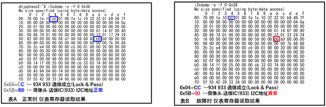

  • Hello Shruti,
    Please check below registers:
    Normal device: reg0x04:0xCC, reg0x4d: 0x17
    Abnormal device: reg0x04:0xCC, reg0x4d: 0x33

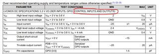

    And below questions need you further confirm:
    1. Is 933 PDB Vih level should refer to CONTROL INPUT or other spec?
    2. In 933 datasheet, we required that V(VDD_n) to PDB VIH delay should be 0 to 16ms, please check below scope shot of the power up sequencing of current 933, is there any risk of this time frame considering the high/low temperature like PDB turns high prior to the VDD_n turns high? I also attached the schematic of 933 below.
    3. Any suggestion to investigate the root cause based on above info?

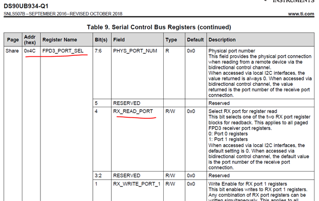

  • Hello Rory,
    Have you tried setting register 0x4C to enable the RX port that you are using on the 934?
    After doing so, please check if you are seeing the expected value in registers 0x5B.
    1. Yes, PDB is considered to be an input (control) to the SER.
    2. PDB should be brought high after all power supplies on the board have stabilized. It looks like it's reaching the VIH min value before VDD_n turns high. Which signal is being probed for VDD_n exactly? (VDDT/VDDPLL/VDDCML/VDDD?)

  • Hello Shruti,
    For the 934 register question, customer set the 0x4C=01h. It means that the RX_READ PORT="0" and RX_WRITE_PORT_0= "1"
    I think it is correct setting.

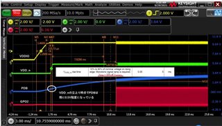

  • Hi Shruti,
    If PDB logic Vih is refer to input control, the minimum Vih is 2V, so Vih timing is M8 in the scope shot, 90% V(VDD_n) timing is M7, there is 7.9286ms(t3 value in the d/s) delay measured in the scope shot. Can you please help check again?
    And now we suspect that if the device and external capacitor temperature variation may cause t3 shorter. How about your thought?
    I will ask for the detail probed VDD_n signal, is there any difference between these four signal?
    For the LOCK status change and BCC CRC error in 0x4d, any finding or test we can do to investigate?
    Thanks.

  • Hello Yuta and Rory,
    Thanks for sharing the 0x4C register value.
    How frequently are you experiencing the issue of not being able to read the SER_ID from the 934? What are the power up sequence details? Are you powering up the 933 SER first and then the 934 DES? Or is it some other situation?
    Can you try doing a digital reset (register 0x01) of the DES (934) after link up with the SER (933)?
    I looked again at the picture and saw that the blue PDB signal is less than 2V in the white circled region and becomes high after 9.8064s (as seen in pic). This power up sequencing looks fine.
    I am also looking into your other questions and will get back to you in a few days.

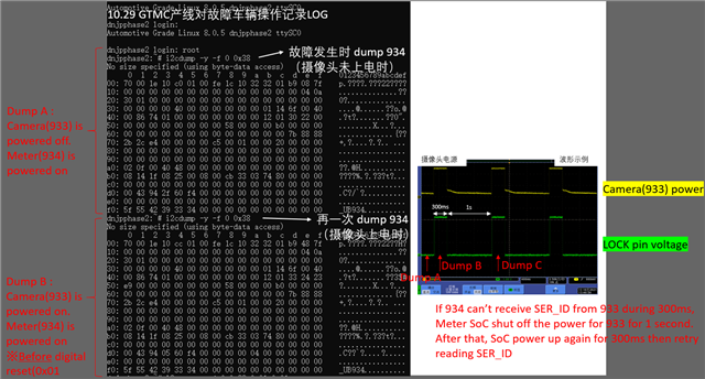

  • Hello Shruti,
    >How frequently are you experiencing the issue of not being able to read the SER_ID from the 934? What are the power up sequence details? Are you >powering up the 933 SER first and then the 934 DES? Or is it some other situation?
    A. From SOP to now, we know about 12pcs in near 9Kpcs. It seems that no clear pattern has been found, but once it reappears, the anomaly will always exist. Camera in Sunny side, we do the repeated test, no recurrence. One thing notice, all camera in our product line, we do high and low temperature start-up test. But we don't know if there are some tests in Meter(Denso-934) side.
    A. Customer will try it soon
    Customer really want to know the root cause why 934 load the SER_ID=00 during LOCK=H. Car OEM rushing Tier1 and TI to find out the root cause so I need below answer as soon as possible.

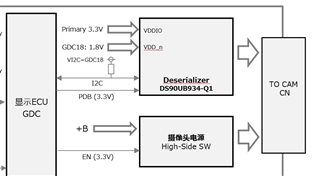

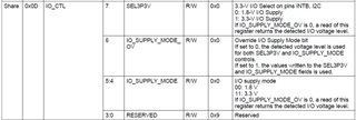

    We found that in 934 side, VDDIO=3.3V, VI2C=1.8V, PDB pull up to 3.3V. Now they did not over write 0x0D register, reg 0x0D=B9. Do you think there will be the root cause of BC communication failure?
    And to solve this VI2C voltage level configuration, need we set IO_SUPPLY_MODE_OV or IO_SUPPLY_MODE or either of them?
    I also searched below e2e post, it said This voltage is applied to I2C and PDB pins together, since PDB(3.3V) and VI2C(1.8V) from different level, is it necessary to make them same?
    https://e2e.ti.com/support/interface-group/interface/f/interface-forum/992198/ds90ub954-q1-i2c-with-1-8v-and-vddio-3-3v
    BR
    Rory

    I am not sure if that is the root cause, I will have to look into that. By default, both I2C and I/O are tied to VDDIO. So, you will need to program the 0x0D register setting to override what you actually want to use. PDB and I2C don't have to be the same.
    Shruti

    1. Is that ok to only write 0x0D bit6=1 then 0x0D bit7=0 or any other config need to be done?
    2. If VI2C=1.8V, VCCIO=3.3V, no 0x0D over write, VIH of VI2C(min) if 0.7VCCIO=2.31V, is there any risk to send over write command since high level(1.8V) is less than 2.31V. Or must customer to tie VCCIO and VI2C together in hardware?
    3. Confirm if the root cause is from the VI2C setting, and the detail explanation.
    Many thanks.

  • Hello Rory,
    You can write to register 0x0D to configure both bits 6 and 7 at the same time.
    However, we recommend that you use the default voltage levels for PDB and I2C. Please follow the typical connection diagram in the datasheet which shows how the supply voltage pins are connected.

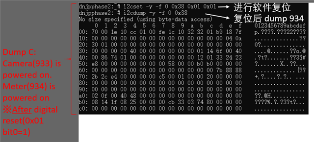

  • Hello Shruti,
    Attached is the 934 register dump. Left one is normal one(They can read SER_ID). Right one is abnormal(Can't read SER_ID)
    They can read all other local register of 934, so supply voltage of PDB and I2C should not be an issue as you mentioned.
    In both cases, the LOCK, PASS status are High. And the 0x57(BIST_ERR_COUNT) is 00.
    Do you have your thought about the root cause by checking these register dump?
    Yuta Kurimoto
  • Hello Shruti,
    Now customer change the 0x0D  to 0x79, but Back channel cannot connect successfully. Must them to tie VI2C and VDDIO at the same voltage on hardware or is it ok to over-write 0x0D in register? Do you have met similar case before?
    In below e2e link,  said the I2C and PDB must be together.
    https://e2e.ti.com/support/interface-group/interface/f/interface-forum/992198/ds90ub954-q1-i2c-with-1-8v-and-vddio-3-3v/3664641?tisearch=e2e-sitesearch&keymatch=IO_CTL#3664641
    And for the LOCK, PASS status, it is stable, we also test the MAP, the link margin is ok.

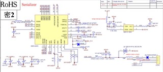

  • Hello Shruti,
    Sorry for asking again.
    Do you come up with any root cause from 933 side why SER_ID become 00? we need to list up all of possible root cause from both 933 and 934 side.
    This is external E2E forum so I will send you the 933 side circuit diagram and power up sequence by email.
    Yuta Kurimoto
    We recommend that the supply voltage of PDB/IO and I2C should be the same. I have not met a similar case before where they are different. Please try supplying the same voltage to I/O and I2C (VDDIO pin).
    Can you please try doing a digital reset (register 0x01) of the DES (934) after link up with the SER (933)?

    Currently in customer side, it is hard for them to tie I/O and I2C voltage together. Since we asked them to change the 0x0D [7:6] but did not work. So they ask that must 934 work on same I/O and I2C voltage level, or is it ok to keep them different and change the 0x0D?
    For the second item, they tried the digital reset but the issue did not disappear either.
    We have no additional idea and been pressed from customer, can you please help check further action we can do to solve this problem? Any thing we can do please let us know. Thanks.
    BR,
    Rory
  • Hello Rory,
    We recommend using the same voltage level for the I/O and I2C. In your case, it may work if you set reg 0x0D.

    In the meantime, customer trying Digital reset(0x01 bit0=1) solution to solve this issue. After the digital reset, the SER_ID can be read. It seems this digital reset solution working well but I want to double check if there is any other conflict about digital reset solution? (For example, in case only resetting 934 side, is there anything to take care such as retry timing, register value, etc.?)
    Yuta Kurimoto
  • Hello Yuta,
    Powering up the SER first is not a hard requirement. However, we recommend it as a best practice to reset the DES after the SERs have powered up to allow for more consistent lock times & AEQ settings.
    You are doing a digital reset bit 0 which resets the entire digital block except the registers. So, I don't think you need to worry about resetting any registers.

  • Hello Shruti,
    Now customer care about that if every digital reset can solve this BC communication issue with high confidence so that they can use this as walk around solution currently. Thanks.
    BR,
    Rory
  • Hello Rory,
    We recommend doing a digital reset after PDB or after SER initially locks since the SER is powering up second, after the DES is already powered up. If this "SER_ID not loading," issue is resolving with the digital reset work around, then you should be able to use it.
    Shruti

    Q. When is the SER_ID load timing?(Before LOCK? or After LOCK?). If possible, can you disclose the detail of flow chart inside 933 and 934? it will be very helpful.
    TI field team is having daily customer meeting with Tier1 and OEM everyday from 3 weeks ago. Customer pushes us to provide each answer as soon as possible. I really want to solve this soon. Your help is essential for this.

    For the margin analysis at -30C, customer is still struggling. Because the USB2ANY is 3.3V pull up, and their 934 is 1.8V pull-up. So they are creating level shift circuit.

    I have a question about SER_ID(0x5B bit7:1) register in 934. After LOCK is stable and 934 loaded SER_ID from 933, If SoC overwrite the SER_ID register as different value, is the SER_ID maintained?
    (For example, the 934 firstly load 0x58 value as SER_ID from 933 during LOCK is stable. After that SoC overwrite the 934's 0x5B=0x00. In this case, is the SER_ID in 0x5B register maintained as 0x00? or Will the 934 immediately re-load the correct SER_ID(0x5B=0x58) from 933 because forward channel frame which contains SER_ID is send every 3.7us?)
    I'm seeking if there any possible root cause outside IC.

  • Hello Yuta,
    You can write the SER_ID in the DES at start up since you know the default value (in 933) and then communicate with the 933.
    The default SER_ID is 0xB0 in the 933. I am not sure why you care saying "correct SER_ID(0x5B=0x58)."
    I am not sure why you would want to write 0x00 to reg 0x5B while the SER_ID in 933 is 0xB0. Can you please explain how that would help to check root cause outside IC?

  • Hello Shruti,
    I made mistake. The correct SER_ID is 0x5B=0xB0.
    I understand SoC of 934 side don't need to write 0x5B because SER_ID is auto-loaded from 933. However I'm suspecting if SoC of 934 side had made some mistake to write the 0x5B (for example, incorrect program sequence, incorrect SDA/SCL high low timing, mistake for Read/Write command)
    That is the reason why I want to ask if the 0x5B register. If FREEZE DEVICE ID=1, it prevents auto loading so the 0x5B can't reload SER_ID. If FREEZE DEVICE ID=0, will the 0x5B reload 0xB0 as soon as it receive forward channel frame?

  • Hello Yuta,
    0x5B[0] "FREEZE DEVICE ID," this bit prevents the auto-loading of the SER device ID from the forward channel. So, yes, if they enable this bit, then the SER_ID won't be loaded when it is received from the forward channel.
    So, yes, If FREEZE DEVICE ID=0, the 0x5B register loads 0xB0 as soon as it is received via the forward channel frame.
    Can they share their programming sequence and how they are reading and writing to the 934 registers at start-up? Are they running any script like imager initialization script on the 934 at start up?
