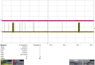

We encounter a problem on a custom design using the PHY Ethernet DP83848-EP.
At power on, when an Etherent cable is connected, even when the PC connected at the other side doesn't send any frame, there is a signal on RXD1 and CRC of the RMII bus.
To avoid any potential problem from external component, we have connected the PHY from one side to the transformator & connector RJ45, and to the other side (RMII), to nothing (we cut the line for tests). There are two case:
1- the PC doen't send any data (check with wireshark) -> the parasite signal is present
2- the PC send data -> our data are present with the parasite signal
It looks like we are in a failure mode.

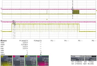

We test to change the registers without effect. We cut the MDIO line, without effect. Here is the scheme and some screenshot of the "parasite" signal.
Its main characteristics are:
- there are "little communication" and "big communication"
- No period have been identified
"big communication" are ~720 µs large nearly all bits are 1 and ~43 periodic bits are 0
Another interesting point is :

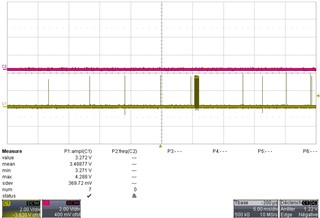

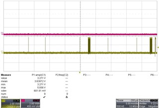

- when I send my data each 5 ms, I lose some unitary frame and packet of 15 frames
- when I send my data each 10 ms, I lose some unitary frame and packet of ~7 frames
- when I send my data each 2.5 ms, I lose some unitary frame and packet of 30 frames
--> the PHY seems to "sleep" sometime ~75 ms
Has anyone experiment such a problem, an idea of the mode in which we are, or a solution?

    - We can see the "strange signal" on RXD1 and CRS only. There is nothing on RXD0, RXD2, RXD3 (in RMII we don't use RXD2 and RXD3 but we have to check)

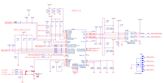

    From pin-out of magnetic (shared in schematic earlier) it looks structurally ok. You may share the datasheet of magnetic and test results of loopback when available.

    - for a reason, the phy lost synchronization (blackout during ~75 ms)
    - Then the descrambler operate and we can see the strange signal during 2~720 µs

    Last point, on our shematic, there is a component against ESD. Do you think it could be faulty?

    To do a few checks on the board, we can check following :
    1. Does it improve by increasing the caps on center tap of transformer to what is recommended in datasheet : 100nF + 100nF (instead of 22nF).
    2. Give 50MHz clock through a clean source (not sure about the quality of reference clock to PHY on pin XI). If the rise/fall are slower or signal integrity is poor of this clock then with any activity on the board can degrade the jitter performance of this clock further and can cause poorer link performance.
    3. Try putting 10pF of cap around Rbias resistor. (to filter any coupling to this sensitive node)
    4. Check the placement and type of the decaps on PFBOUT, PFBIN1 and PFBIN2 (is it as per datasheet recommendation : table 3-10).
