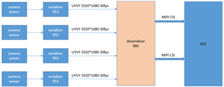

Hello, Ti engineers,
We are using Ti ds90ub960 chip to collect 4-channel camera image data, as shown in the figure below:
As a module, sensor + 953 can normally output uyvy 1920 * 1080 30fps image data,
How to configure 960 registers to capture images? I hope Ti can provide a 960 sample code.
    Where are issues in your setup coming from?  If you have set your strap values correctly and are able to communicate with the 953s you should be able to forward the video data accordingly in the FRD_CTRL registers.
    Nick
         At present, only the input source (sensor + 953) is known, and the data input to 960 is uyvy 1920 * 1080 30fps. We need to initialize the register of 960.
    However, since we debugged 960 for the first time, we don't know which basic registers need to be initialized to get image data?
    It should be relatively simple, if you can verify that the serializers can communicate with the 960 you should just need to enable CSI forwarding in 0x20 and then configure the CSI port in register 0x33.
    So set register 0x32 to select which CSI port to turn on then enable it in register 0x33.  Also set register 0x20 to enable forwarding of all 4 ports.
    Nick
