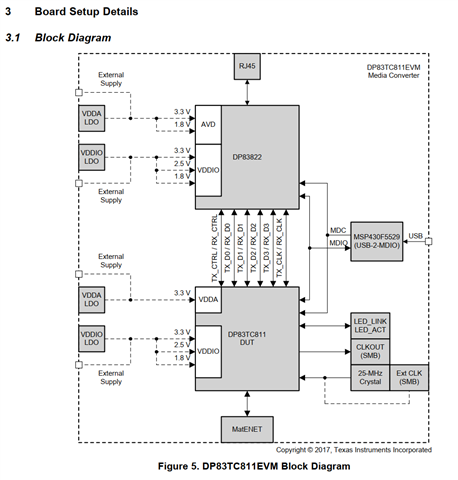

Hi team,
The customer’s project is to convert the network data from automotive Ethernet to normal Ethernet data output, and the current plan is to connect the two chips directly, so there are a few questions to ask.
1、Can these two chips directly connect to complete the conversion of network data from automotive Ethernet to normal Ethernet data?
2、If it can be directly connected, what attention should be paid to the directly connected wires?
