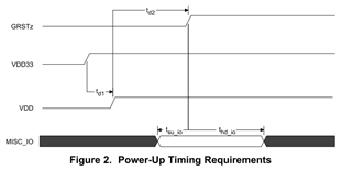

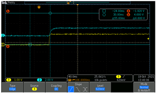

We use the TUSB8041. But on one board after power up it is no connetion PC and downstream connettor. The other board is OK and we can use the USB.
TPS2003CDRCR is on board as VBUS switch. On EN pins 4 and 5 is the voltage value after power on 2V5! instead of 3V3.
So the VBUS 5V is not activated!
Do you have any idea what could be wrong?
