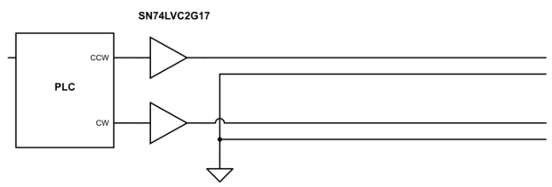

  • These are optically isolated inputs; they do not really need a differential signal. (Or do you have a long cable between the driver and the motor controller and need high noise resistance?)
    Page 44 says that the drive strength for these inputs must be more than 5 mA at 5 V.
    If you already have 5 V signals, you might be able to connect them directly to the STR8. If your signal source is too weak, a simple logic buffer like the SN74LVC2G17 will help.

  • At each input, you have a current loop, so the signal is differential even if it is driven from logic gates. (Use a twisted pair for each +/− pair.)
    To convert from 3.6 V to 5 V, use devices with TTL-compatible inputs, e.g., 2× SN74AHCT1G125, or SN74AHCT125.

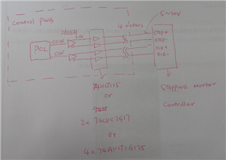

    So I add  SN74AHCT125 between 26LS31 and stepping motor controller in order to amplify 3.6V to above 5V.
    The control signal flow: PLC signal - 26LS31(diffential signal) - Add SN74AHCT125( or other buffer gates) - stepping motor controller.
    Confirm please.
  • You do not need the 26LS31, and its output signals are not valid logic signals. What I meant to say is that you should replace the 26LS31 with the logic buffers.
    If the signals from the PCL are 5 V, you can use any 5 V buffer, e.g., the SN74LVC2G17. If the signals from the PCL are 3.3 V, then you need buffers with TTL-compatible inputs.
    You need buffers only for the + signals. The − signals can be connected directly to ground.
  • Dear Clemens Ladisch
    About current loop, I understand.Thanks.
    About logic buffer, I still have some questions.
    First, in my control PWB, I used PCL chip(PCL6143).
    Beacuse I have a long cable between the driver and the mortor controller about 4 meters.
    So differential signal should be needed, I think.
    Differential Line Driver is not needed?
  • The two currents in the lines to the + pin and from the − pin have equal magnitude and flow in opposite directions. This is differential.
    A differential driver like the 26LS31 would try to make a current flow in both directions, from + to − for a high input, and from − to + for a low input. The motor controller input does not allow a current flow from − to +, so a differential driver is not necessary.
    The PCL61x3 outputs 3.3 V signals, so you need 2× SN74AHCT1G125.
