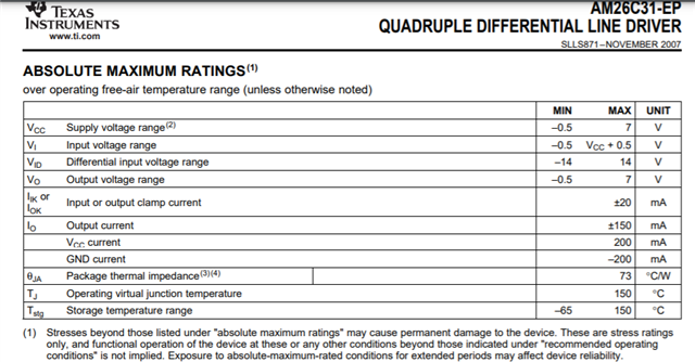

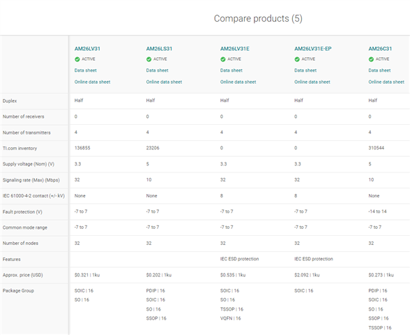

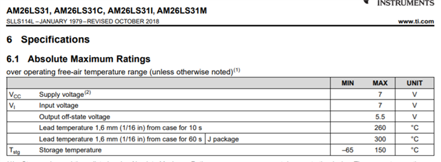

Hello dear:
I have a question about the features of RS485 transceivers. There is a character named FAULT PROTECTION. But I can't find the working principle corresponding to this item in the data sheet. Can anyone help to explain to me how does it mean? And the comparison data on it between  AM26C31 AND AM26LV31?
