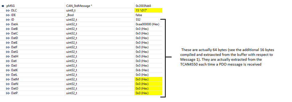

  • The problem consists in the payload extracted from the TCAN4550 by MCU2 being different from the payload in the message.
In the table below I list the increasingly complex PDOs I have generated from MCU1 and how they are received on MCU2:
Below are the 2 messages that cannot be read. the yellow part is the change with respect to the previous message, so I'm quite confident that TCAN4550 actually received those messages, but it is failing to provide their correct content.
Message 1 – 48 bytes wrongly received – this happens each time the PDO with CAN ID 0x228 is received (with payload of 48 bytes)
Message 2 – 64 bytes wrongly received – this happens each time the PDO with CAN ID 0x228 is received (with payload of 64 bytes)
The PDO is read from FIFO RX 1, and apparently everything is working fine until I extract the payload of messages with a payload size of 48 or more.
I can see looping extracting messages from the 5 FIFO elements of FIFO RX 1, whose element size is set to 64 bytes. Message ID and DLC are correct.

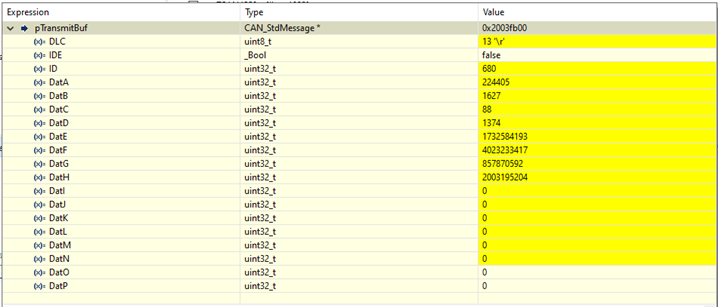

    In the meanwhile I discovered that I actually do have a problem also when transmitting. I'm adding the explanation in the main post
  • I actually discovered that I have a problem also when transmitting, and even with payload of 32 bytes:

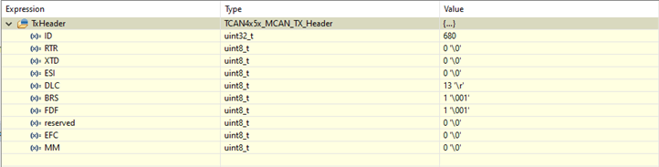

    At a certain point I am calling the function TCAN4x5x_MCAN_WriteTXBuffer:
    The parameters to this function are displayed below:

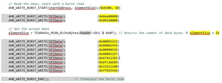

    I am following the actual write operations to the controller, as displayed below:
    But I end up with the following message transmitted, where the last 4 bytes have no connection with the programmed output:
  • Hi Eric, thanks again for your support. Here some answers to your questions:
    • I'm using a slightly modified version of the TCAN4x5x_MCAN_ReadNextFIFO, but the modifications should not pose any threat (I'm attaching it for reference anyway - look for "ABB" to detect variations from the original version) .
    • The array where the payload is to be stored is big enough (a 64-byte message) for the expected payload
    • by debugging step-by-step I can see that in case of 48-byte and 64-byte messages data are corrupted directly from the SPI read operation
    The examples below show what i rear or write from SPI (in yellow) in a case where the message is working (payload = 32 bytes) or not working (payload = 48 bytes)
    Message with 32 bytes payload
    Message with 48 bytes payload
    It can be seen that the SPI read operations already fail in giving back the expected content based on the received PDO.
    Additionally, they always return the same value.
    This is in line with what I see from the debugger at the calling function (once returned from the TCAN4x5x_MCAN_ReadNextFIFOFromFilter)

  • Hi Eric,
    Thank you for your suggestion, even if I don't understand how the proposed modification could help in solving the problem. As per my understanding, in fact:
    1. the caller is in charge of passing the correct parameter,
    2. the callee is in charge of working on the passed parameter. TI's function, expecting to work on an unsigned char pointer, will apply the correct arithmetic on the passed parameter, assuming it is of the correct type
    As you mentioned, an array of uint32_t objects can be filled by using a pointer to uint8_t, and the actual instructions on the pointer are carried out by TI's functions, which assume that the passed parameter has the correct type. This fact should make pointer arithmetic work as expected. Additionally, the passed parameter, even if of a different type (uint32_t * vs uint8_t *)  points to the beginning of the buffer.
    So, the fact that I use an array of 16 adjacent uint32_t objects is equivalent to have an array of 64 uint8_t objects, as far as TI's functions are concerned.
    However, I tried to cast the passed parameter as advised,
    TCAN4x5x_MCAN_WriteTXBuffer(txqfsRegister.TFQP, &TxHeader, (uint8_t *)&(pTransmitBuf->DatA));
    but, apart from removing the compiler warning on the type, the compiled code does not change at all. In fact, when trying to download the newly compiled code to the target, I get the message below:
