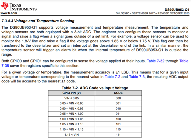

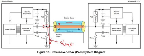

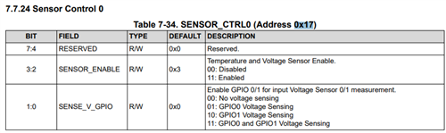

Dear team
The customer have found that there is a short circuit at the position of 953 POC, which will cause high temperature and hot hands.
They would like to know if there is a register that detect whether the POC position is short-circuited?
Many thanks
