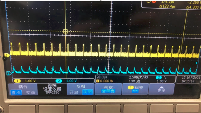

Yellow is input, and blue signal is output, it could be found that the data lane is abnormal.

    Are they probing lane 0?
    The input data does not look like HS data. If they disabled the LP in the DPHY440, they must only send the HS data to the DPHY440.

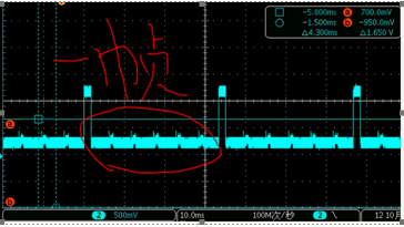

    The configuration of sensor is continue mode. The data lane could switch LP during blanking, but CLK lane couldn't switch LP  with data lane during blanking, and the clock lane would always keep 300mV. While sensor would restart MIPI during frame(blanking), so the clk lane would rise between frame, it would keep 300mV during Hblanking, and didn't switch LP with data lane. Data lane would enter into LP status with Hblanking and Vblanking, so could  DPHY440 configure under this situation?
    The input and output waveform of DPHY440 are as belowing:
     (note: during frame(blanking), so the clk lane would rise between frame, it would keep 300mV during Hblanking, and we found that the clock lane has a little higher)
    Best regards
    Kailyn

    Is the scope plot the clock lane? It still seems to show the clock is switching between the LP and the HS mode.
    If you don't disable the clock LP, does it work correctly?
    David

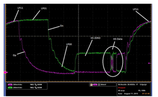

  • Kailyn
    Looking at the scope plot they provided, it does not look like the clock is in HS continuous mode as it switches between LP and HS. Below is an example of LP switching to HS mode.
    If they do not use the I2C commands to disable the clock LP, are they seeing the correct signal on the DPHY440 output?
    David

  • HI,
    I am not sure what the question is in the above thread.
    For DPHY440 CLK input, if its LP is disabled through the I2C configuration, then the DPHY440 CLK expects to see HS data only and you need to make sure the HS data electrical characteristic meets the DPHY440 HS RX input requirement as shown below.
    David
