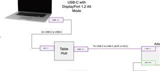

         Below picture show my customer's requirement.  they need redriver or retimer recommendation to support 2m and 7m trasmit distance.
I think TUSB1044 is suitable one. but not sure if this device can support 7m  cable.  Thanks for your recommendation.
