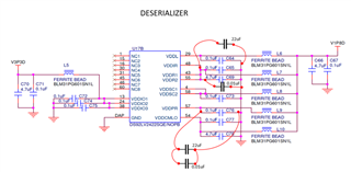

Also attached are images of the schematics of both the serializer and deserializer to show the configurations.

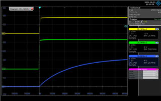

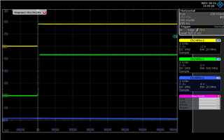

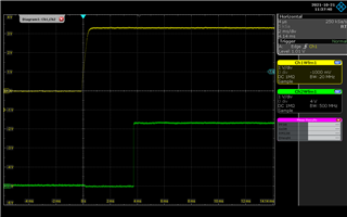

    1. Also, can you provide start-up waveforms for the SER and DES, showing each of the 1.8V and 3.3V power rails and PDB signals?
      1. In our design we have the BISTEN of the serializer and the deserializer tied together, so we are going into BIST mode by setting the PDB of the deserializer high and then setting BISTEN of the serializer and deserializer high. So the order would be:
        1. Serializer power and PDB comes up (see image below Serializer_1.8V_3.3V_PDB)
        2. Deserializer power comes up PDB stays low (see image below DeSerializer_1.8V_3.3V_PDB)
        3. PDB and BISTEN are set high (see image below DeSerializer_PDB_BISTEN)

  • Hi Logan, I believe we have found the solution to this problem.  We have added some more capacitors to our board on the deserializer power filters.
    we are now able to run in BIST mode error free.  We got this idea by looking at the eval board.  They have a different filtering scheme there.
