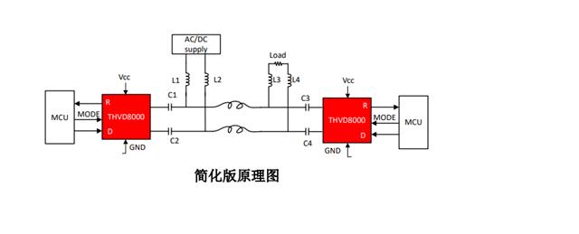

Dear Team,
I notice there is possible to power the bus with AC supply. But I don't find the details to guide this kind of design. Could you provide the requirements or reference to start with? Thanks a lot!
Tess Chen
Dear Team,
Tess Chen
Tess,
This app note might answer some of your questions about the AC and overall design requirements for the THVD8000:
There is also a reference e2e post that addresses this question by Hao Liu. Check this one out here:
Please let me know if you have questions about these references,
-Tyler
