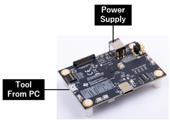

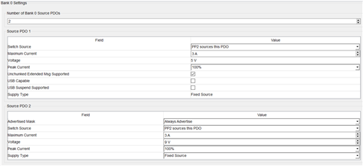

I would like to set configuration of TPS65987EVM by “TPS659xx Application Customization Tool”.
The setting method is as follows but I can't change VBUS of DFP.
(Even if I set it to 9V(PDOs is 2), it will be 20V.)
Could you please let us know if you have any concern?
[Tool Setting]
1.Select New project -> TPS65988DHH -> Select Standard -> Downstream facing port(DFP )only -> Port setting -> Transmit Source capabilities
2.Select Number of Bank0 source PDOs is 2
3.Flash From current project -> USB to SPI Adapter is FTDI
4.Verification is displayed so communication is normal
[Hardware Setting]
