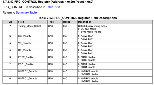

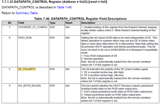

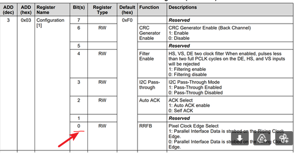

Hi Team,
Customer now use 941+948 and now position of the screen display is abnormal. It is a dozen pixels away from the left side of the screen and cannot be adjusted by 941 6a/6b
Customer found their display screen parameters only could be trigger through falling edge. If through rising edge, it display abnormal.
Could we change the falling edge or rising edge of DE mode and HV mode through 941 or 948?
We found it could change through 926 register but can't find it in 948...
