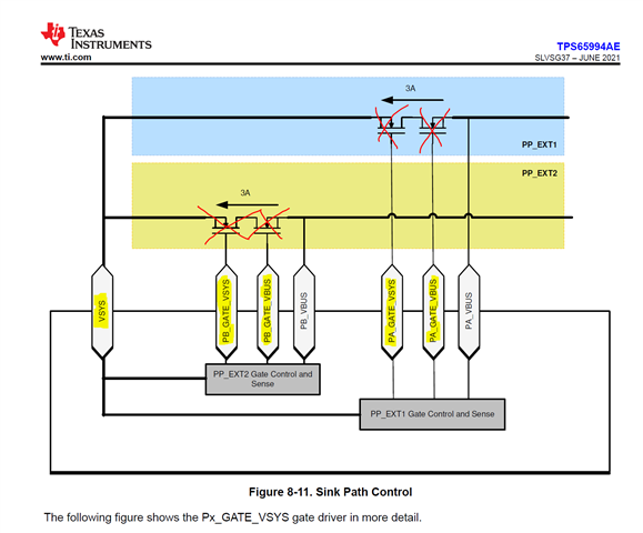

Hello. How to connect pins VSYS, PB_GATE_VSYS, PB_GATE_VBUS, PA_GATE_VSYS and PA_GATE_VBUS if we don't want Sink Path. Can be those pin's simply unconected (floating). And can external transistors will be omitted. Our application is PD controller for ATX matheboard. Only Source path is planed for USB-C connector. Many Thanks. Martin Vit

  • Do you plan to support only a 5V source path?
    The 2 paths that you are showing as remove in that figure are the SINK paths, so they could potentially be removed.

  • Hello Chuck. Thanks for repply. Yes I will use just 5V source path. That means that I could keep all pins for Sink path not connected right?

  • Martin,
    If you are not using the Higher Voltage sink capabilities, then you do not need to implement the sink power path at all.
