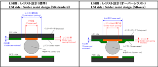

Part Number: XIO2001
Hi Support Team.
Please tell me the following information of XIO2001IZAJ.
・Copper pad diameter(mm)
・Copper pad thickness(mm)
・Solder mask openting diameter(mm)
・Solder mask openting thickness(mm)
↓Reference diagram

Greetings,
Please attached note XIO BGA ZAJ 3821.hpa_xio2001_zaj_08_30_08.zipboard layout to measure these different parameters.
Regards ,Nasser

Greetings,
I am able to read PCB layout that dimensions that i sent you. However, my tools are not accurate enough so i am afraid of making these measurements. Please attached note ZAJ package dimensions. Additionally fab drawing of the file sent you earlier, has this information as well. Your pcb layout designer can use these to optimize copper pad and solder mask openings.
Regards ,,nasserZAJ pkg foot print mpbg703d.pdf
Greetings,
Using my tool, i measured copper pad to be 0.1778mm and solder mask opening to be at 0.254mm. Please note this is a legacy old board and we do not have access to the board stackup to measure solder mask and copper pad thickness. Please consult your pcb board manufacturer.
