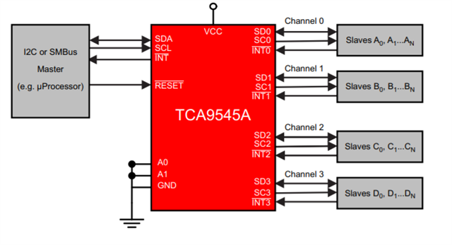

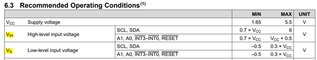

Hi Team,
I have two questions about the TCA9545A.
1. Am I right in saying that the VIH/VIL specs only apply to the Master SDA/SCL lines and do not apply to the slave SDx/SCx lines?
2.  Will there be an issue if Vcc comes later than the Master I2C signals? Something like Vcc gets back-powered or violating the POR requirement?
Thanks!
Roy
  • 1. Yes. The TCA9545A's internal I²C slave is connected to the master SDA/SCL pins; it never cares whether the slave lines are low or high.
    2. The absolute maximum ratings and the recommended operating conditions allow voltags above VCC.
  • Roy,
    You are correct in saying that "the VIH/VIL specs only apply to the Master SDA/SCL lines." The VIH and VIL input voltages do not concern the SDn/SCn pins.
    There will not be back powering issues when VCC powers on later than the Master I2C signals coming in. This was originally a problem with the RESET on the PCA9545A device to VCC. There was a case where if VCC < /RESET, /RESET would back-power on the VCC pin. TCA9545A fixes this situation.
    -Tyler
  • Thank you, Tyler and Clemens for your comments!
    A follow-up question on item 2. If Vcc comes later, will it affect the incoming Master I2C signals? Such as clamping?
    Thanks!
    Roy
  • No; the SDA/SCL inputs a high impedance with any voltage (up to 6 V).
