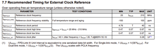

I can't find pin REFCLK0/1 in reference application in chapter 9.1 in the datasheet. please give me some advice for how to choose the frequency of external clock resource for REFCLK0/1.

Hi Allen,
Section 7.7 Recommended Timing for External Clock Reference has this information. See the datasheet, and below:
