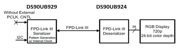

Do we have document or can show me
How to use DS90UB929-Q1 to remote control I2C slave device(Display) throw DS90UB924-Q1?

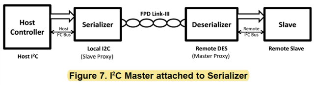

    Registers 0x7 and 0x8 can be programmed to configure a remote slave attached to the remote deserializer. Register 0x07 sets the Slave ID and Register 0x08 sets the Slave Alias. This document may also be helpful to learn more about I2C communication with these devices: I2C Communication Over FPD-Link III with Bidirectional Control Channel

  • Hello Ben:
    Does it mean UB924 no need to do any register setting?  If yes,
    First one, we are follow below step by step on UB929.
    Set I2C Pass-through (Register 0x03 as 0xDA)
    Set Slave ID[0] (Register 0x07 as 0xA8) (example: Slave Display I2C address is 0x54<<1)
    Set Slave Alias[0] (Register 0x08 as 0xA8)
    Read/Write to Slave display using address 0xA8
    Is everything setting correct? But now we still cannot Read/Write Slave display used above setting.
    BR.Doug
  • Hi Doug,
    The 924 shouldn't need any configuration for this function.
    Is the address 0x54 an 8-bit address? If it is already a 7-bit address you do not need to shift when you program the Slave ID and Alias. Can you provide the script you are using or the commands you are programming?

  • Hi Doug,
    Registers 0x07 and 0x08 are programmed with the 7-bit address of the remote Slave device, so if 0x54 is already in 7-bit format, you should program 0x54 in those registers. Also, can you confirm the SER and DES have established lock? You will not be able to communicate to the remote slave if lock has not been established.
